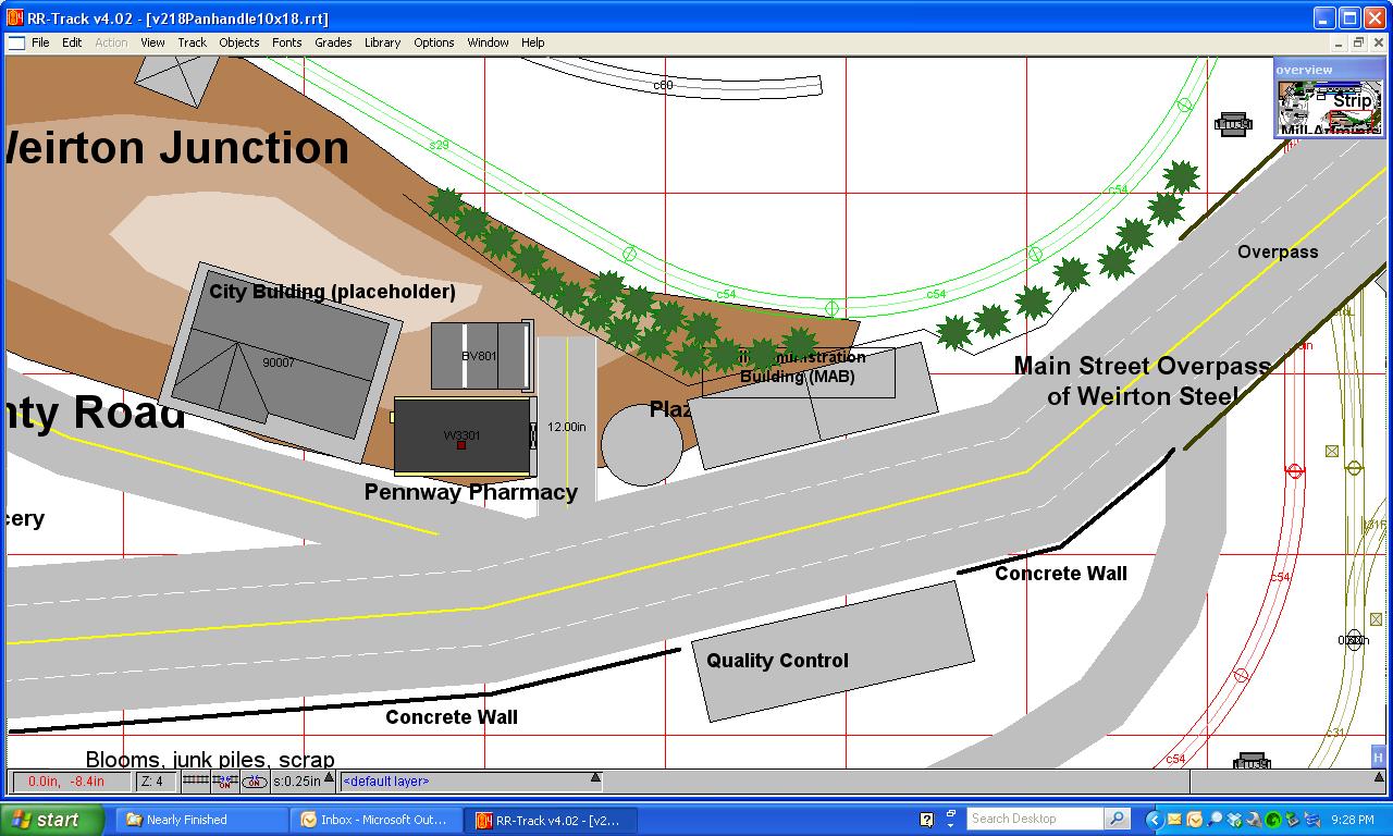

While looking for an opportunity to do the work on the overpass, I've had a chance to think about how to tackle the area shown below:
Currently, this is open grid benchwork with subroadbed and track. An irregularly shaped table top supports the Weirton Steel mill area just to the right (out of the picture). Some preliminary thoughts:
That's the current thinking on this module. It helps to write it down and get some feedback.
- At the bottom of the diagram, the area south of the concrete wall will be 1-2" lower than Main Street. A 1:48 figure entering the front of the Quality Control Lab would exit the rear of the building at a lower level.
- As a result, the concrete wall lining the south side of Main Street will have a total height of 4-4.5". The thought is to have a masonite board form the floor of the module and use ribs (like on the Standard Slag module) to support an elevated Main Street. It's not desireable to have the floor cover the entire module because it makes reaching the building wiring very difficult (Lesson learned from Standard Slag). We'll either have to cut big holes or be very selective about what is covered; module strength and rigidity is a factor as well.
- North of Main Street, buildings will sit on another elevated section of masonite. That section will end at the scenic backdrop divider.
- North of the divider, pink foam will be used to taper the hillside down to track level in the Weirton Junction area.
- On the northwest corner of the diagram, a small hill partially encircling the City Building will be blended into the divider.
