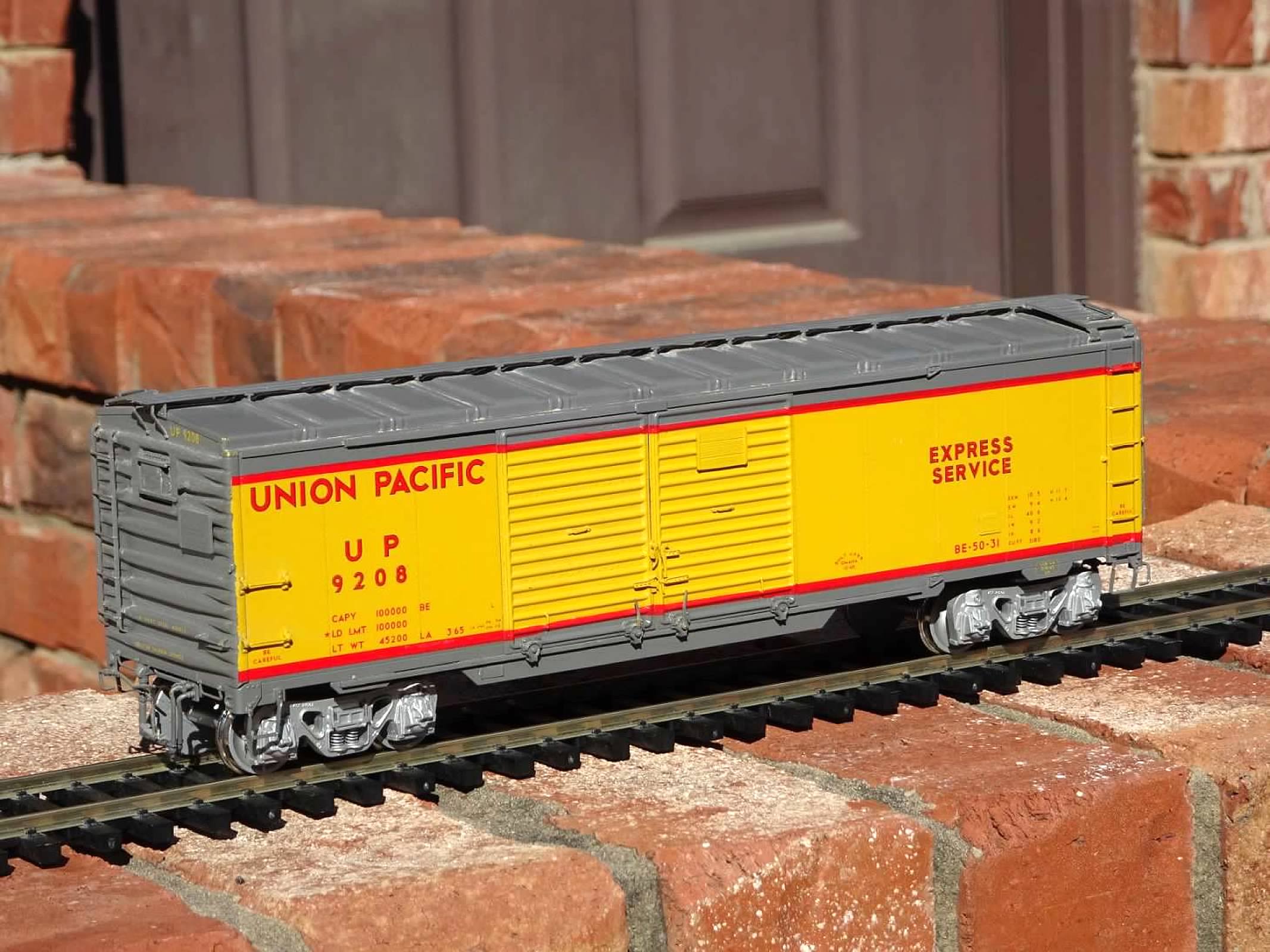

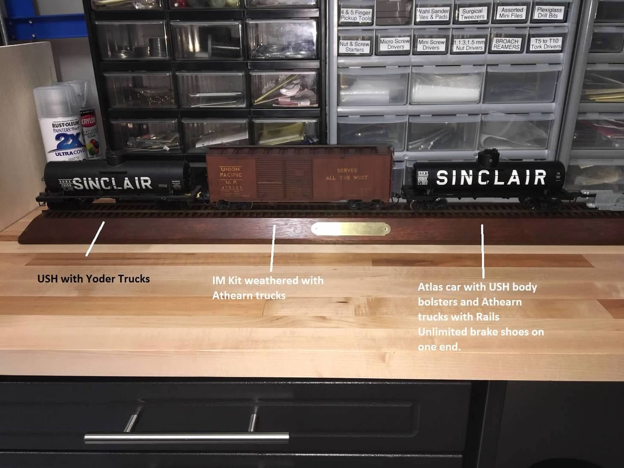

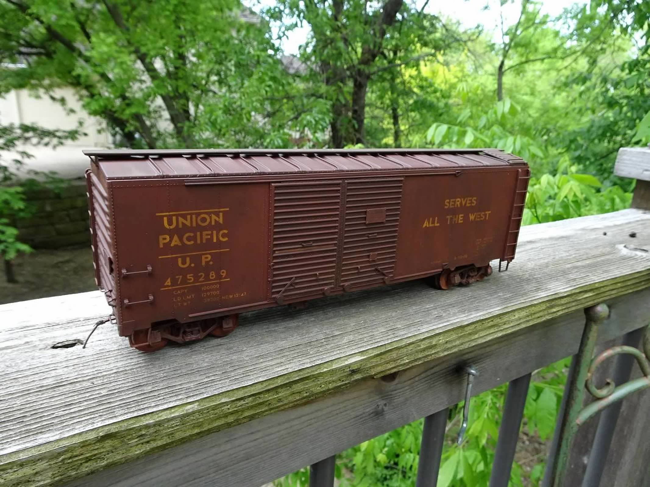

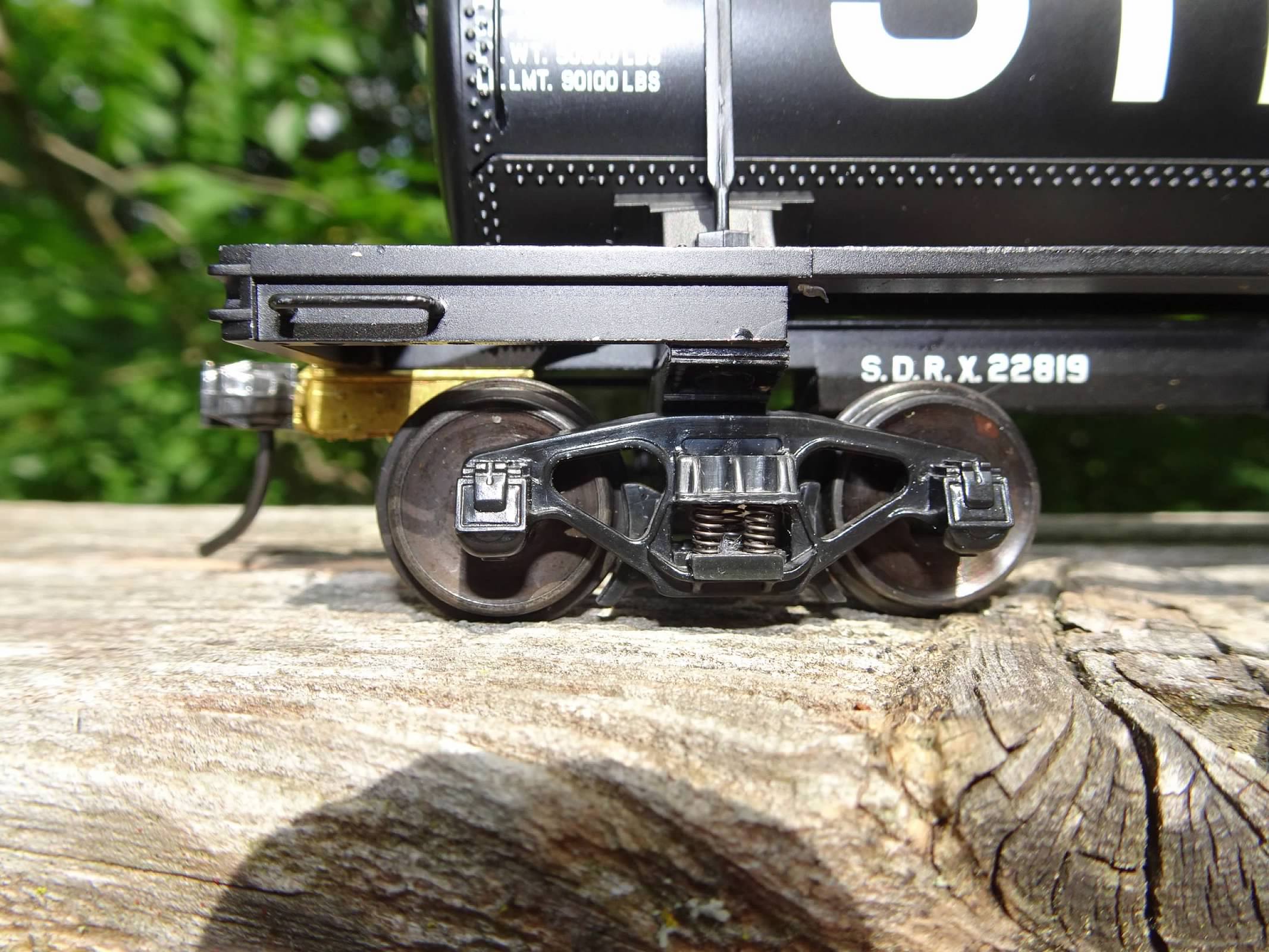

Re: Freight car projects
Postby up148 » Wed Aug 13, 2025 1:51 pm
Sorry posted to the paint thread and not the Freight car thread.
I believe I posted these before. Boxcar is my 1st attempt at weathering with pastels and I like them. But, I found out like many things in life, all pastels are not created equal.
The tank cars were experiments in installing USG plastic bolsters, somebodies plastic brakes shoes on Athearn trucks and some brass coupler pockets with more detail than the standard Kadee box.
Last is a Beaver Creek Express Boxcar that was only imported by this company back in the mid 90's. This one was left on a layout in a humid basement and it shows. I'll clean it up and maybe weather it lightly as these were generally kept very clean running on the streamliner trains.

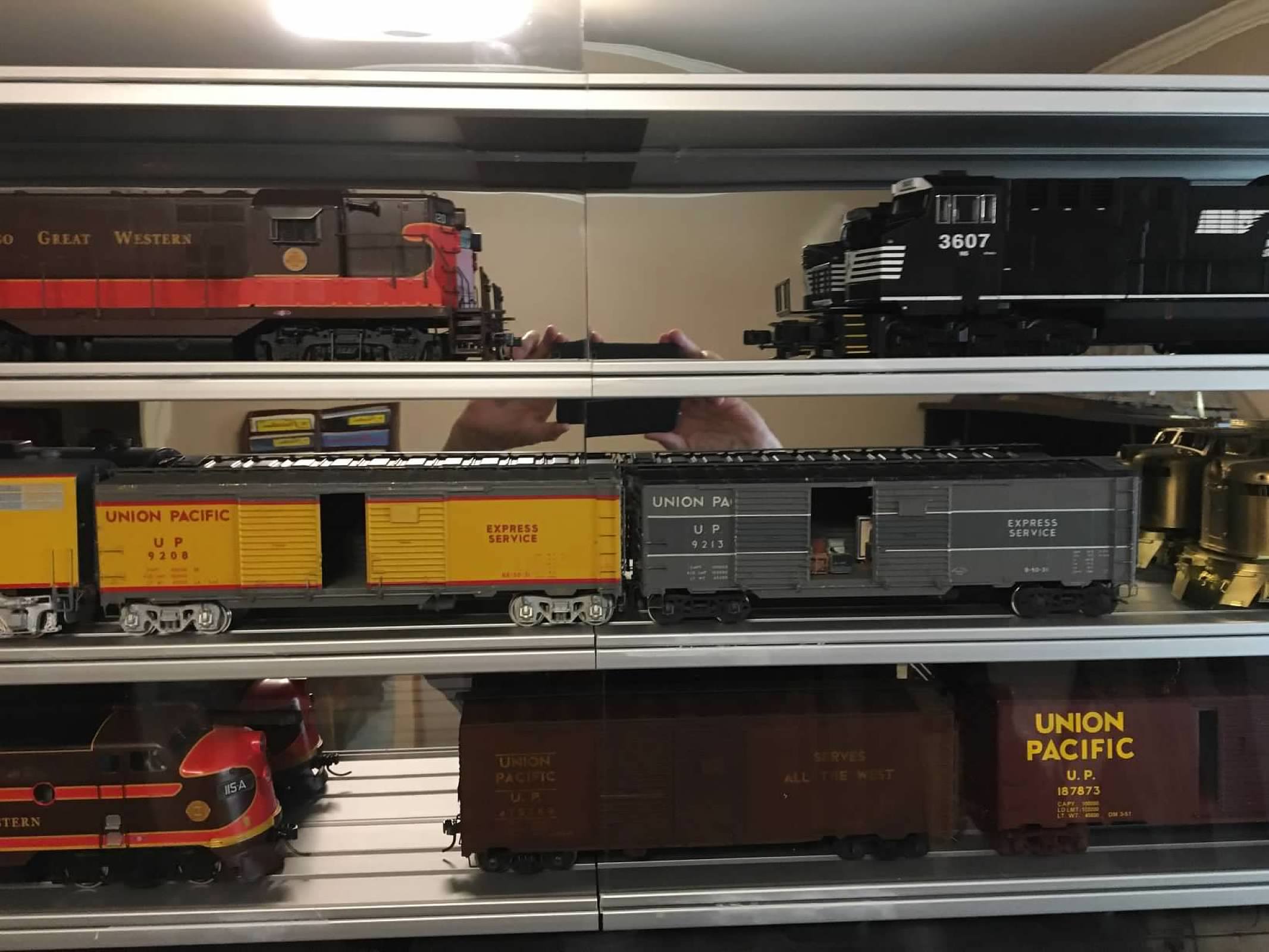

……and maybe a coupler. :wink: Look forward to it. Love the UP stuff. Come to think of it I think I need a service express box car to pair up with my stream liners.
Posts: 4565
Postby up148 » Sat Aug 16, 2025 9:32 am
UP only used them for a handful of years, but they are unique in their build and size. These Beaver Creek cars are the only ones I found to be truly scale. There was an article in one of the magazines decades ago for converting a reefer to an express boxcar and the modeler did a great job. The express boxcars are shorter than a standard boxcar.
The came in many paint schemes from 1939 to 1955 when they were pretty much retired from passenger service. Years later UP came out with newer and longer express boxcars, but being a steam and transition era modeler they had no interest for me.
