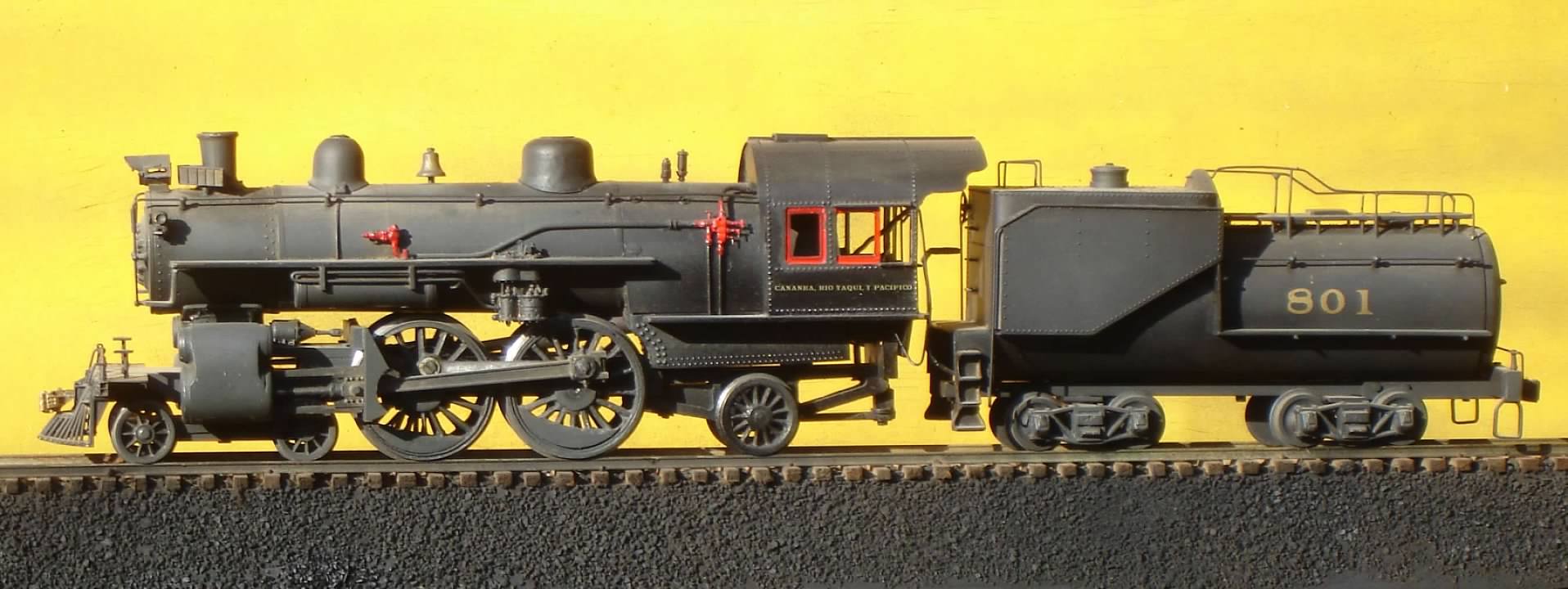

So, I will repeat Maroon's Atlantic here, and then follow up with my SP collection:

Here is my attempt to copy that, using an All Nation boiler (supplied by Maroon):
Note that the tender is a 90 C. I have no 100 C tenders in my collection, but that will get rectified soon. Surprisaingly, the later Lobaugh Pacific tender is long enough, but it is a cross between SP and KCS. I may use a modified Lobaugh in my current attempt, which will be #3001 in Daylight colors. Obviously, this model is neither finished nor powered. It is parked as-is for now, and #3001 is standing on its own wheels, bolts between boiler and mechanism. Start the tender tonight?

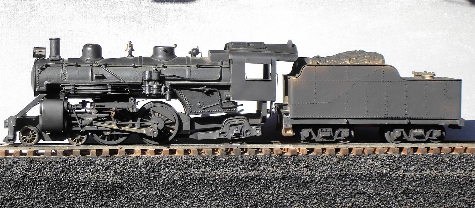

For reference, let me insert a more or less stock A-N Atlantic:

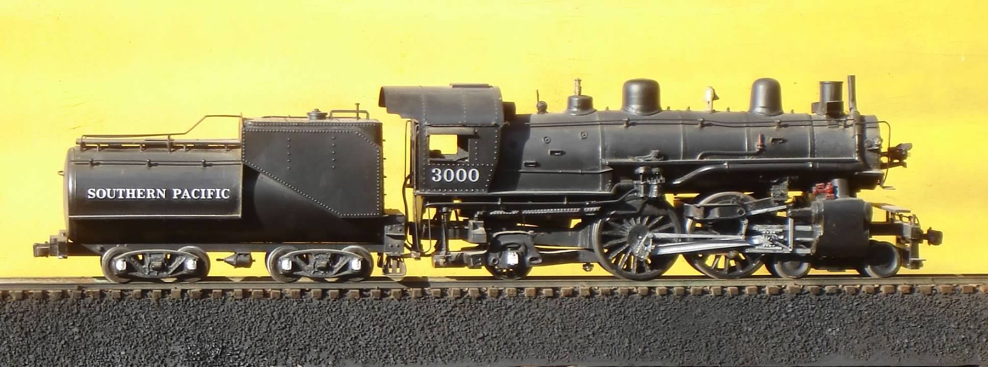

Here is my very first Atlantic - SP #3000. At the time, I was not particularly enamored with the Daylight scheme on anything smaller than a Pacific, but I have now changed my mind. This thing, with cast iron 84" Lobaugh drivers, has pulled ten Kasiner coaches with 3/4" pine flooring and roof insert, and metal trucks, at track speed. Remarkable! It convinced me that for smaller wheelbase models, fully sprung has only to do with aesthetics. If you have cast iron tires and steel rails, the only thing that counts is how much weight is on the drivers that are in contact with steel.

bob turner wrote:Here is my very first Atlantic - SP #3000. At the time, I was not particularly enamored with the Daylight scheme on anything smaller than a Pacific, but I have now changed my mind. This thing, with cast iron 84" Lobaugh drivers, has pulled ten Kasiner coaches with 3/4" pine flooring and roof insert, and metal trucks, at track speed. Remarkable! It convinced me that for smaller wheelbase models, fully sprung has only to do with aesthetics. If you have cast iron tires and steel rails, the only thing that counts is how much weight is on the drivers that are in contact with steel.
I used to astound Joe Rudinski and Woody on Joe's pike when I dragged a SC engine over there.
Joe would holler across the room "Dave, we determined that 12 cars is maximum on our grades!"
I hollered back "Is that a challenge?".
I kept adding cars, I think I emptied the yards at 36.
Gotta love bronze boilers and cast iron tires.

I did an internet search and get no hits for the CRY&P Railroad, and I can't quite make out the lettering on the side of the cab. I also searched for SP subsidiaries (and SP Mexican subsidiaries), but nothing came up that looked close to CRY&P. Bob, would you mind solving the mystery for me? Curious minds want to know.
- Posts: 13428
Re: Atlantics 2023
Cananea, Rio Yaqui, y Pacifico - Sud Pacifico de Mexico subsidiary. Photo in Dumbscomb's book shows 801 with CRY&P on the cab while in Portland Or.

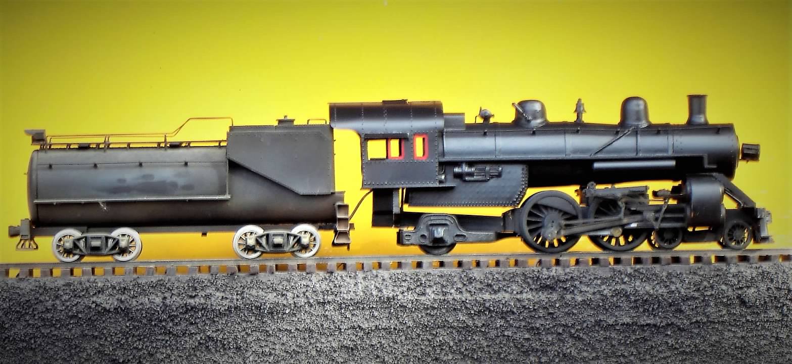

I have two Atlantics, one of which is pictured at the top of this thread. Here is the other:
This was custom-built by Bob Hall, a custom builder in the Seattle area (Bellevue, I believe). Records indicate the model was built in 1994. Bob built many locomotives (north of 30, it is believed). He often would start with a complete chassis. This one has a US Hobbies gearbox but All Nation drivers. I will look for a chance to get this in operation soon. It needs servicing but I don't believe it has any major issues (famous last words).

Re: Atlantics 2023
Just a WAG, but I think h built at least 30 for Garberson.
He must have had over 30 on his railroad.
Plus, he custom-built for folks.
I can think of several names.
And, I have one.
And that's just while I knew him.

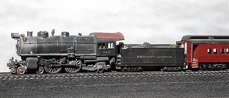

That kind of boiler taper is the all-time most difficult to get right. My Harriman ten-wheelers have a much tamer version, and I have had to redo several of the taper sections to get the mating surfaces correct with respect to the cylindrical sections.
The Harriman Atlantics have a taper, but it is almost not noticeable to the casual observer. An easier Atlantic is the PRR E6, which has been done by lots of folks, including Saginaw and CLW. This one is scratchbuilt, using CLW H10 boiler, Saginaw frame, and Lobaugh drivers. Of passing interest is the fact that the Atlantic has a longer boiler than does the H10, so you can maybe see that I added a half inch to the casting?
Re: Atlantics 2023
Not much clearance between the second pilot wheel and the first driver. Looks kind of hinky.

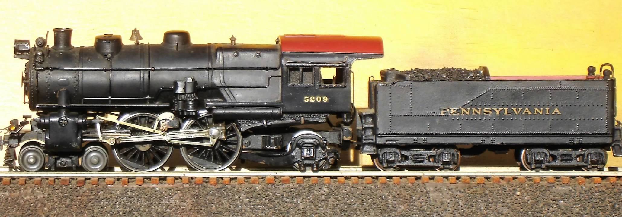

But runs ok. Here is a dead-stock Saginaw, from the collection of Max Schwanda (now in my collection):
Same frame, but different pilot truck. The main difference in the boiler is the sand dome, and while you cannot see it, the sheet metal firebox.

I am not a connoisseur of PRR steam, so I have to ask this question: Your version of the PRR Atlantic is different from the Saginaw. Are there prototypes for both versions or is one more accurate than the other?
