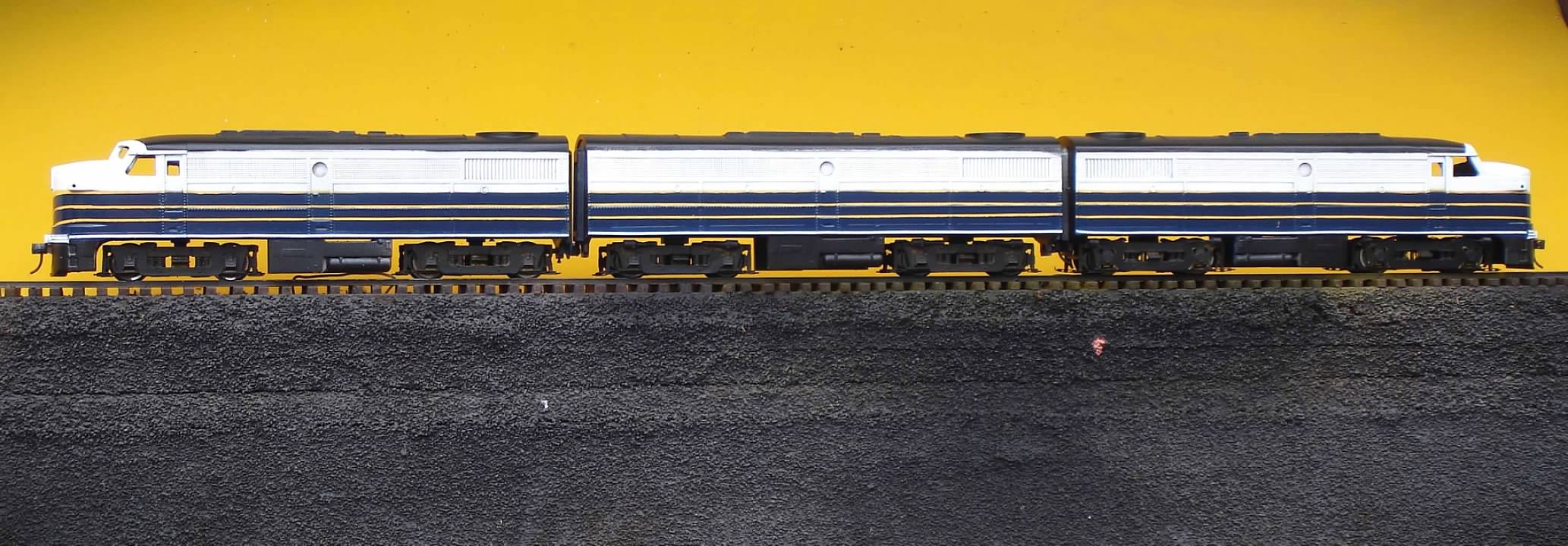

Meantime, here are my FAs in preliminary B&O colors. I used to be a lot better at stripes, using Pilot pens instead of striping tape, and I think I can recover my mistakes here with a dark blue and a black pen, and maybe a re-do with a slightly brighter yellow. But you get the idea.

Great looking set Bob!
Before you seal in your finish though you may want to fix that white upper panel,
as most photo records indicate that portion as an off-white light grey.
https://www.rr-fallenflags.org/bo/bo808alr.jpg
The anecdotal story is the B&O honoring both the "Blue and Grey"with this (a worthy sentiment.)
The Central of Georgia had a similar scheme albeit using orange pin stripes though the same upper portion does appear as white in some photos as well as light blue and then again grey in others.

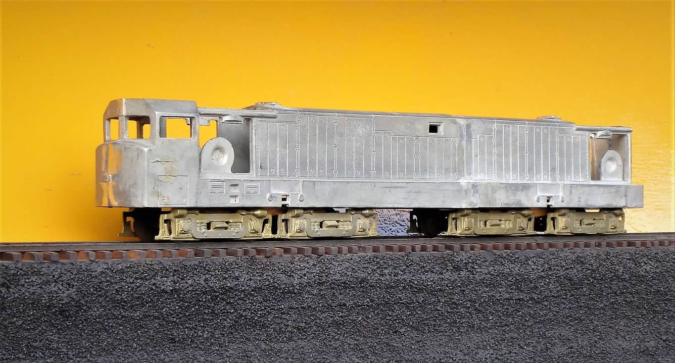

Maroon will recall how damaged these castings were before I applied gentle pressure. As you can see, pressure, J B Weld, and glass cloth did a good job, and so far no cracks have occurred in the finish anywhere. I note that this can be a four axle Diesel "squared."

As I recall, the GE U50 was essentially two U25B locomotives on a single rigid frame. It may not technically be a four-axle diesel, but if we reimagine the title of this thread as "Doorstop B-truck Diesels", then were good. I will post a similar photo when the U50 comes around on the list.
