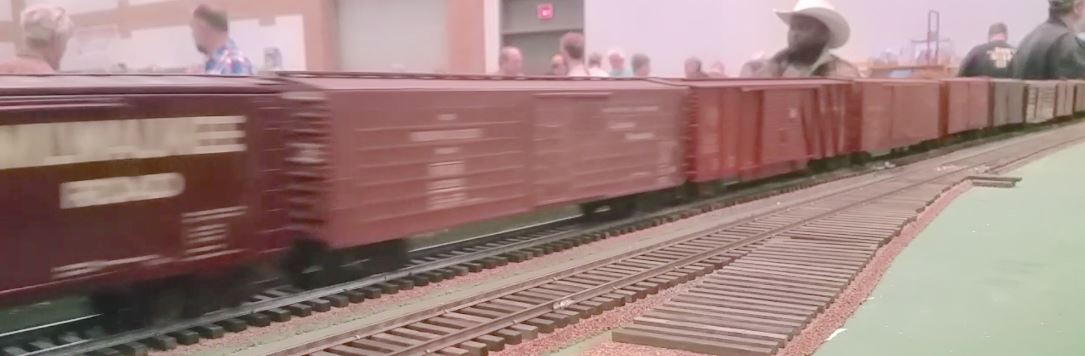

I haven't posted on this thread since last summer, when I wrapped up the conversion of a USH MIlwaukee Road GP-7 from outside third rail to two-rail. The conversion included installation of switchable constant-brightness directional headlights and pickup wipers to all wheels. Since then I have been restoring a bunch of old Milwaukee Road boxcars and reefers:
Milwaukee Road String.JPG (54.35 KiB) Viewed 6763 times

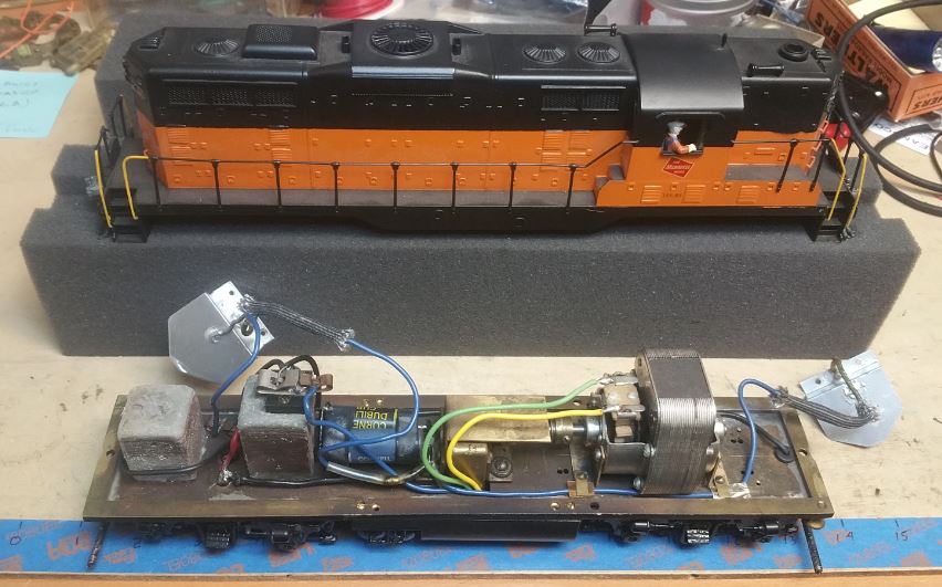

The string is getting long enough now to warrant a second locomotive, so the mate to the first unit wound up on my workbench over the weekend. Here it is in "as arrived" configuration with the body removed:
USH GP MILW RD 2310 As Arrived.JPG (91.45 KiB) Viewed 6763 times

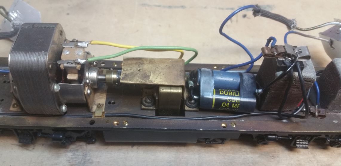

Note the outside third rail pickups and the penlight bulb headlights mounted to stray-light shields:
Pickups and Penlights.JPG (61.4 KiB) Viewed 6763 times
The pair of blue cylinders are capacitors. One of each is in series with each headlight. I have a theory of what the purpose of these was, which I will share if anybody is interested. I am not sure why that unused brass shelf was installed -- maybe to mount the capacitors originally?

Postby ScaleCraft » Fri Mar 15, 2019 2:15 pm
Guess on the caps....reduce low speed light flicker from open frame motor. Set up as bi-polar so direction is immaterial.

Postby J. S. Bach » Sat Mar 16, 2019 5:08 pm
The shelf maybe as a guard to keep the wires away from the driveline?
