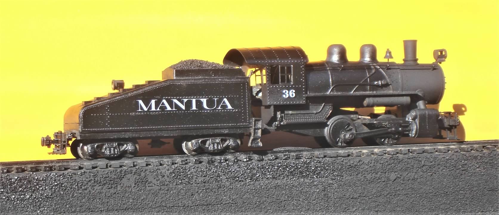

Here is a wood block tender - a smaller version of the ATSF Mallet tenders.
Obviously, the side is a brass overlay - glued successfully using Bargs cement. Sometimes the cement gives way on such things as Walthers passenger car sides, but these relatively large surfaces seem to hold forever. Epoxy and clamps would also do just fine.
The wood is typically anything I have on the shop floor - usually construction wood, like "Western White Wood."
Laminating the block is with Weldwood water based exterior glue - never any problems.
Finish - multiple coats of lacquer based sanding sealer - I buy it in gallon form, but one can buy it an ounce at a time for model airplanes. Brush it on, let it dry, sand with regular sandpaper, and about coat #3 the wood grain is simply gone. Two more coats, then glue the sides on and shoot with your choice of locomotive paint.
This is standard for Walthers passenger car roofs, and I use it on any wood model, including those with scribed sides. I just do one coat on the sides, because I do not want to fill in the plank grooves. But for decals, you really want a very smooth surface.
For models, this is a lot like spar varnish. It seals against moisture, so you do not get cracks and splits after a long display period.

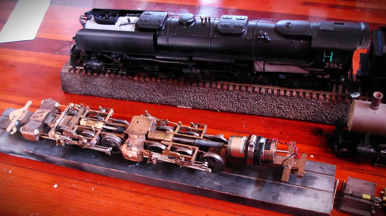

Postby bob turner » Mon Jun 23, 2025 1:59 pm
Anxiously awaiting the Carey video of his Jabelmann Challenger. Meantime I sort of dropped a Harriman Pacific project in favor of resurrecting some fragments into a Jabelmann mechanism. I got many pieces from Bob Stevenson - they are not exact, but close. Side rods are from Lobaugh patterns. Mains are from molds off of an original rod, so ever so slightly shorter. Plenty good enough. Crossheads need an added piece to connect the link to (easy). And valve spindle guides are undersize, but usable.
My big problem was I ran out of original Lobaugh valve gear rods, and had to make my own from .032 brass. I did not get the delicate look I was going for, but what I wound up with was acceptable - especially given that I already have six Lobaugh "Jabelmann" Challengers and really do not need more.
I shall try to get photos of the finished Gersh Challenger and this new mechanism.

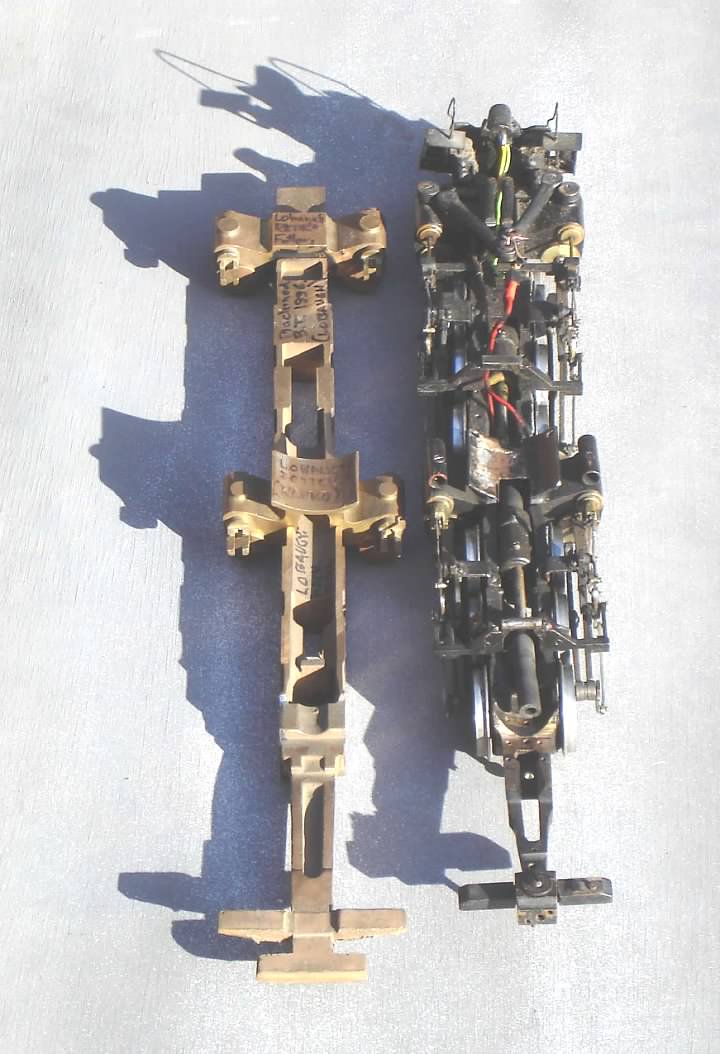

Postby bob turner » Mon Jun 23, 2025 2:19 pm
This is a photo from 2013. The mechanism I am working on is shown in preliminary machined status - it came to me unmachined. So twelve years later I am just about to put the gears together and track test it.
The mechanism on the right is from a model labeled as 3999. I have no memory of that locomotive, or what I did to it -just that it came through my shop for some reason.
Update Jun 25 - 30 minute test run for my cobbled together Challenger mechanism - successful! Only one screw fell out. Non-catastrophic.

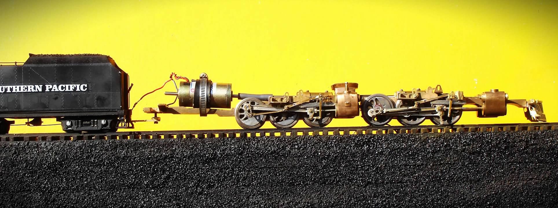

Postby bob turner » Thu Jun 26, 2025 2:01 pm
Here are my latest Challenger engines, fresh off a smooth track test. Note the sheared rivet on the crosshead link of the forward engine - both sides sheared. Might have been due to inadequate clearance between the valve spindle and the joints between radius rod, valve rod, and combination lever.
Cured by more grinding, then forcing a #27 drill bit in to curve the two halves outboard.
Also note the motor mount. It gets replaced by aircraft safety wire if I decide to keep the can motor.
Toyota tubing for the motor to rear gearbox, but cheap vacuum line between the engines. I will replace that with speedometer cable at some point - i need easy assembly, and the Toyota hose just hangs on too tight.
The black Challenger is Gersh's.
