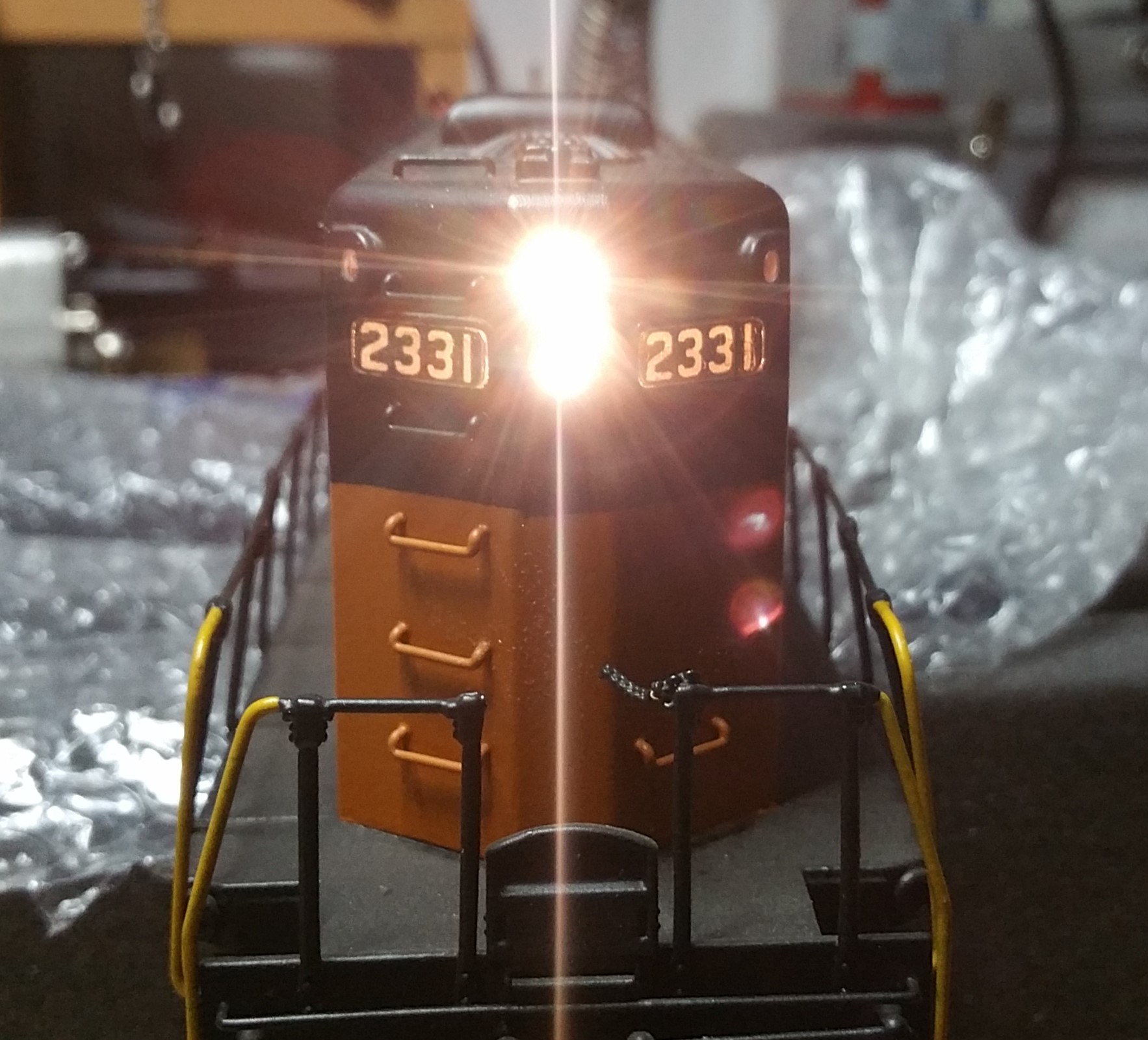

The USH GP7 made it back onto my work bench finally. Like many models of this generation, this locomotive had big round flashlight bulbs for both the front and rear headlights. I really like constant-brightness directional headlights, and I often will install a fancy LED system to do this. However, the one-bulb-per-end in this case lit two headlights, two number boards, and two markers. I didn't want to spend the time it would take to put LEDs on all of these so I decided to keep the setup but switch to low-voltage penlight bulbs. These have a built-in lense, and I set up the bulb so it would focus on the dual headlights. This puts most of the light out the headlights but provides enough scattered light to illuminate the number boards and markers:
I am very pleased with the result. However, I have a question about the marker lights, which can be seen better in this night shot:
As I understand it, the marker lights should be red and shouldn't be lit unless the engine is running light, and then only the rear markers should be lit. Is this correct? If so I will simply block off the back of the markers so they don't light up. I am not such a perfectionist that I need prototypically operating marker lights.

Thanks for the input -- I did a search and found this:
Classification Lights -- U.S. railroads used a single light and outer lens, with colored lenses in between that could be changed as needed. Canadian roads used three separate lights; on diesels these were often located near the numberboards on the front of locomotives. The purpose of classification lights was to help identify the train on which they were displayed. The three colors and their meanings were as follows:
White. Indicated an "extra" train not shown in the timetable. For much of railroad history, train-movement authority was granted by timetables. If a train was listed in the timetable, it had the authority to operate according to its printed schedule. Deviations from the timetable, such as a train running late, were handled with train orders from the dispatcher. Under this "timetable-and-train-order" system, it was important that trains kept as close to schedule as possible, and that any special trains not shown in the timetable be clearly identified as such with a white light. Many freight trains operated as extras, and thus carried a white classification signal.
Green. Indicated that, while the train displaying the lights was a regularly scheduled one, a second section was following behind it. This was done, for example, when ridership demand exceeded the capacity of a single passenger train. If there were too many passengers for a single section of, say, New York Central's 20th Century Limited, a second section was operated, and, if needed, a third, fourth, fifth, and even sixth. The engine of each section except the last would display green lights. While each section was a separate entity, the timetable's "train 25" would not be considered to have passed a given point until the last section of the train had gone by. For operational convenience, special trains that otherwise might have carried white "extra" signals were sometimes operated as advance or second sections of regular, but unrelated, trains.
Red. Indicated the end of a train. A train, be it a single engine, a group of engines, or an engine(s) with cars, must have a marker on the rear end. In the (relatively rare) situations when the last element in a train would be a locomotive, the red lights would be lit.
That makes it all clear. I think for general purposes I would want the lights off. Having said that, white is certainly acceptable, as one can simply state that the train running is an extra.
Dave, I already have installed two slides switches under the loco as it is -- one for each headlight. This allows me to MU this guy and have the headlights on or off as needed. Note that the classification lights do not have their own bulbs -- they are lit by the stray light from the penlight bulbs, so there is no way to switch the classification lights on and off individually (unless I add more bulbs, which I am not going to do).

If your classification lights are "lit" by bypass scatter from the headlights, it would be prototypical
if all the trailing units of your engine consist would have their headlights switched off (and thereby
not illuminating the class lights). The only legal requirements are for the display of classification lights
or flags indicating any required classification of the train (extra train, additional sections of scheduled trains, etc.)
on the leading end, and markers (red lights or red flags) on the rear of the train. All other classification
and/or markers should be extinguished under normal circumstances. It should also be noted that regular
trains with a schedule will not display signals--only the added sections of a regular schedule will display
the green classification lights, indicating that there is another section of that train following.
