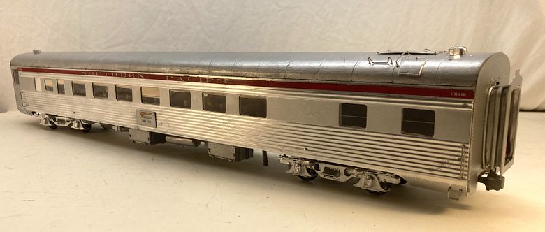

A Chester Coach for that T&NO Sunbeam in the later "Sunset" scheme. Should have a PA for these soon too.

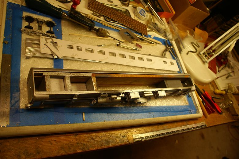

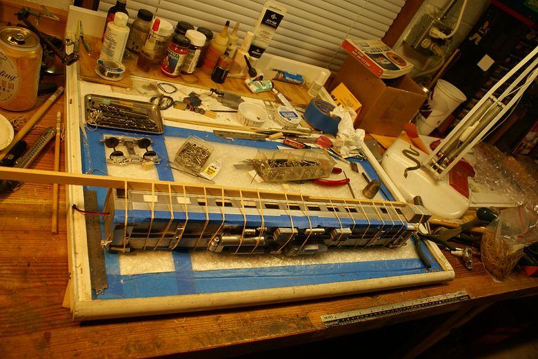

Thought some of you might enjoy seeing the primitevo build shots aka "how the sausage gets stuffed."
Note using cut basswood sheet for the restrooms and bulkheads to brace the soft aluminum rolled sides against and support the roof frame.
Had a lot of help with these cars; Maroon scored a virgin coach kit (and two used "beaters") and did the entire battery powered light harness running the length of the train, commissioned and later machined and assembled with bearings, the prewar truck castings by Dennis Mashburn , scored the resin underbody detail parts (Care of Bill Badsen's Delta Models) all which really pop on the finished models and look a lot better than anything I would have fabricated myself not to mention saving a lot of hours.. Many thanks guys.
