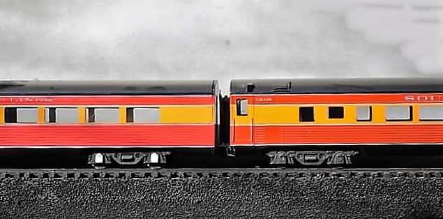

Four days inactivity - I must have done my Daylight cars somewhere in these pages. But here they are again!
First, I have a string of converted Kasiners - crude, I admit, but all I wanted was a string of Daylight cars. The corrugation is the NYC version, and SP used an inverse variant, but you cannot tell from the photos. Also, the letterboards and logo plaques are auto body putty, filling in the corrugations at appropriate points.

I captured two more images, but they are really low resolution. If I don't get around to taking better photos, they will be next. One compares the Speer extrusion to the Kasiner. I do have one exquisitely done B-C Daylight coach, of which I should have a photo somewhere.

The one with silver journal lids is a Speer extrusion - arguably the most accurate ever done in O Scale. The other one is a very well done B-C models kit. As I understand it, it was built and painted in the Sacramento area many decades ago, using actual SP enamel obtained from the shop.
