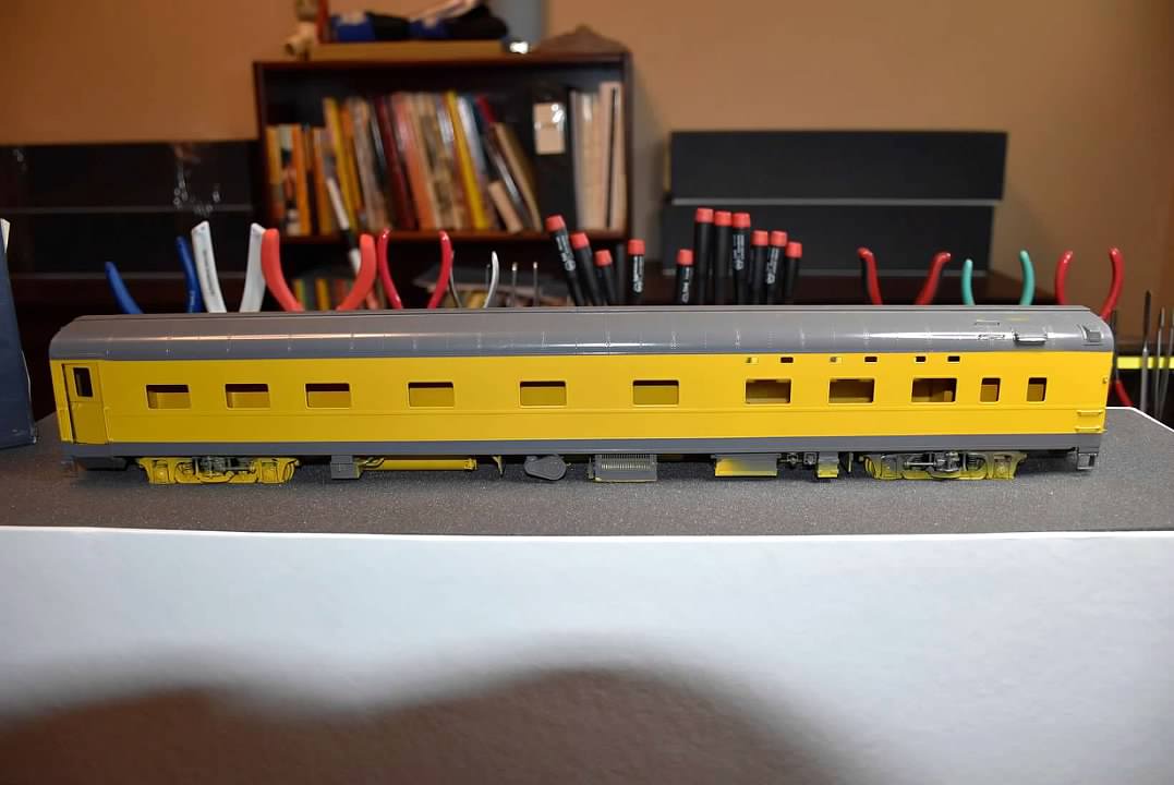

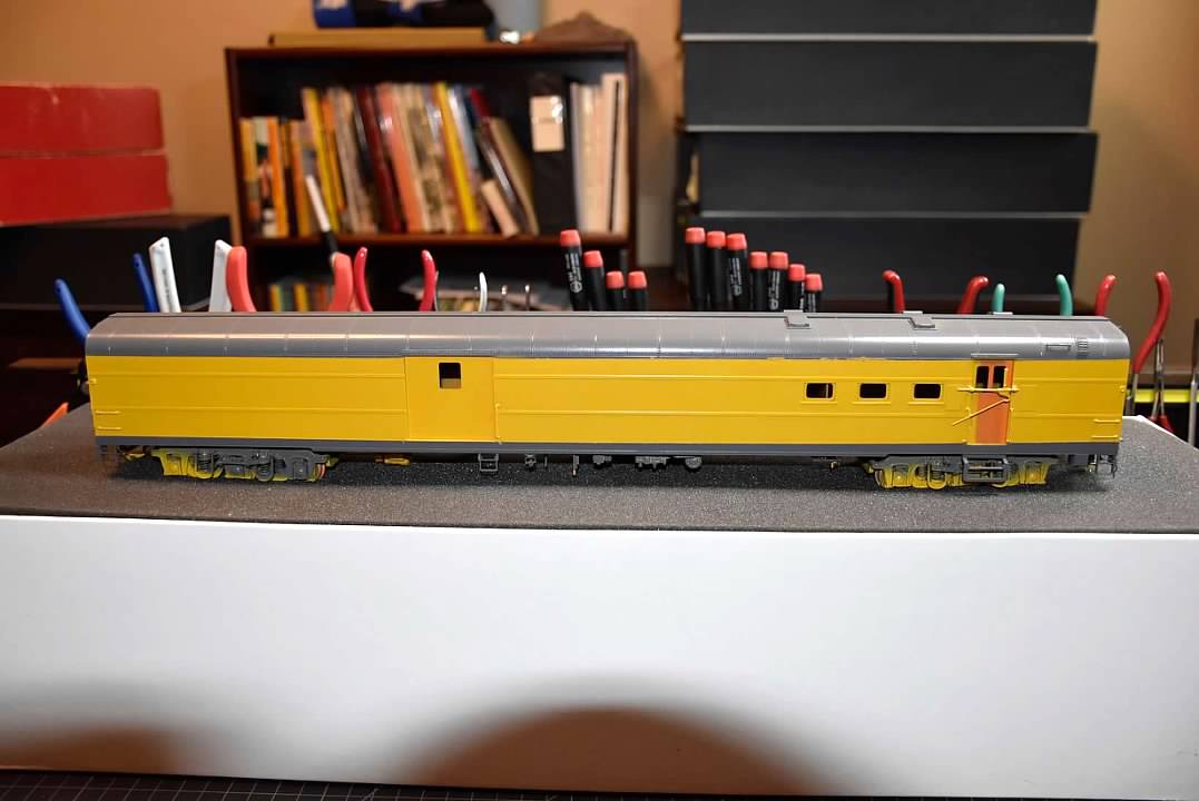

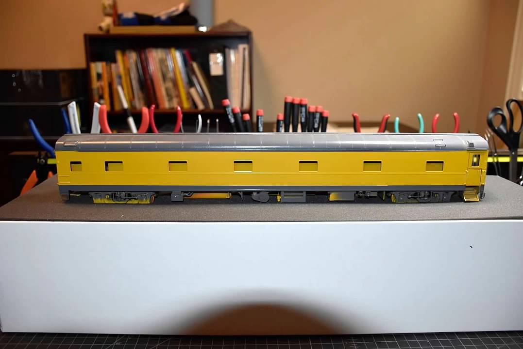

Looks like it might be slowing down a little here and we can't allow that, so here are some before photo photos of some Wasatch cars I sent to Dan Pantera last January. Every time I look at them I can't understand why the original owner didn't remove the trucks before painting and tape off the under floor details. But, his folly allowed me to buy them right. All have orange peel and dirt in the paint. Reminds me of the Dirty Harry saying "a mans gotta know his limitations". :lol:

Their folly is your gain indeed Butch, really like these Wasatch ACF's a lot. Also one of the few series of prototype models with complete readily available commercial UP decal sets thanks to MicroScale. Great looking car bodies.
Help me out here as my memory is foggy and I know we've discussed this here in the past.
The Wasatch are the evolution of the old Kemtron/Briggs cars or dimensionally a new line altogether?
I like the old Kemtrons, tricky as they were to build, they're evidently good fodder for kit-bashing too if you have soldiering "chops" like Bill Badsen.
