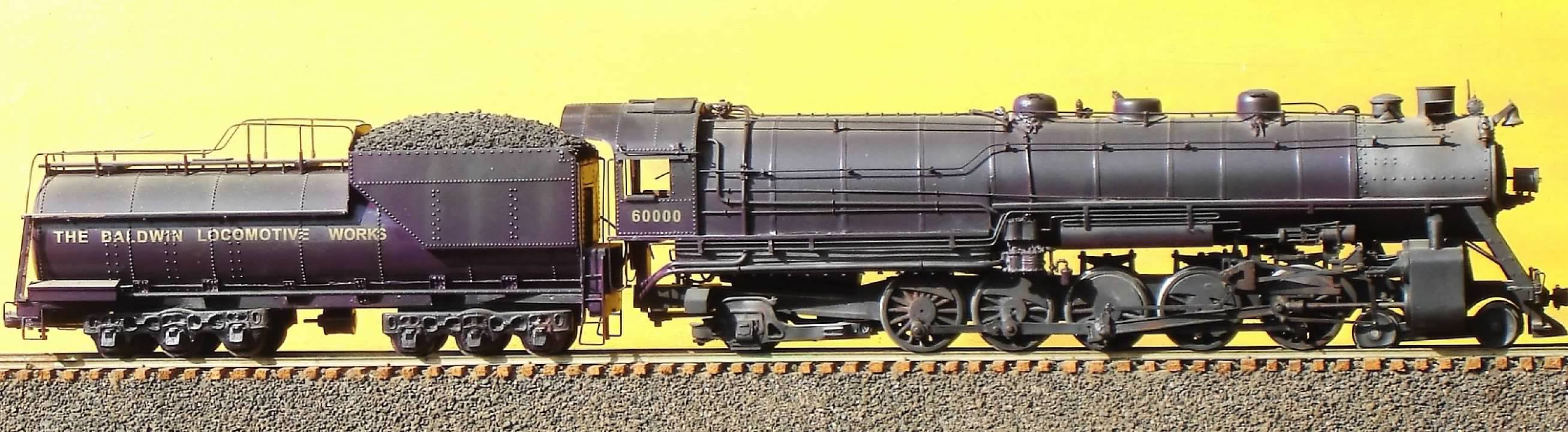

Thanks. I think all of my SP steam is in this thread. I may assemble another backup Mallet or two, and possibly a few more Pacifics, but I am essentially done. One more photo of the 60000 is in the queue.

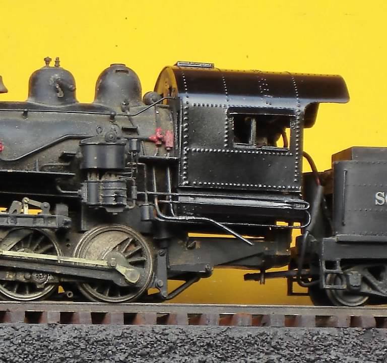

I am sort of looking at cabs on my Pratt/Lobaugh switchers - I have one with pretty much exquisite detail, including brake beams and sliding cab windows. I note that I only posted two of them here, and I have four!
The one with sliding windows had one flaw that has been bothering me - giant pins were used for cab rivets. First I tried grinding every other pin off. Better, but still ugly, Then I tried diling them down - twice. Waste of time. It looks like this one will get a new cab wrapper. Not sure I have a "before" photo, but will stick an "after" photo here in a bit.
Of interest to maybe a few - this one has "step-down" gears, like Carey's Challenger!

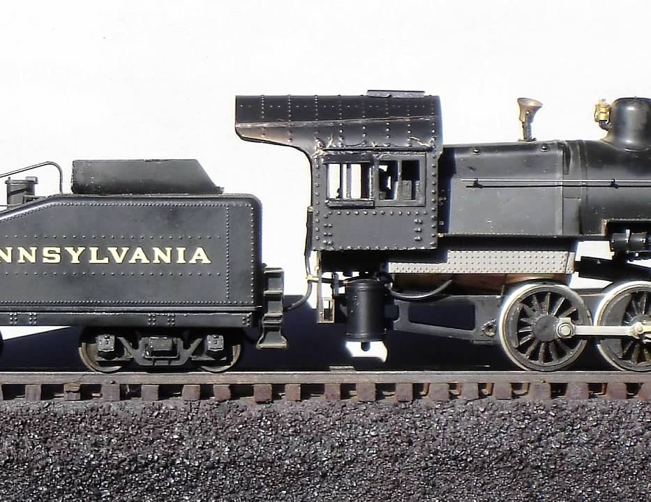

I did get the new cab on, but am still not happy with the rivets. I think I need new female dies for smaller rivets. I will think about a photo - it is kind of embarrassing, although a huge improvement.
Edit: I think what has happened is my rivet dies have been enlarged through use. I did harden them, but I am not all that scientific about the process. I will grind the tops of the dies and try again. Later, I will post a photo of this version, and maybe wrapper #3. I need to do the same for a Williams B6 that looks like it has buttons instead of rivets.

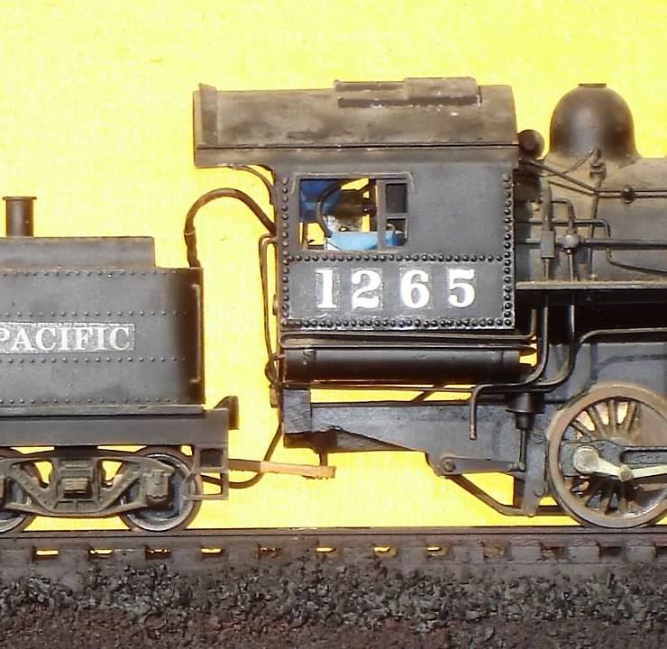

Here is the new cab - Yuk!
For comparison, the original:
My first clue should have been this ugliness - I tried to mute the size, by filing them down. Did not work. So, new cabs before 2023 for both!

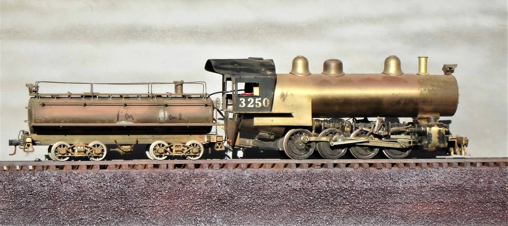

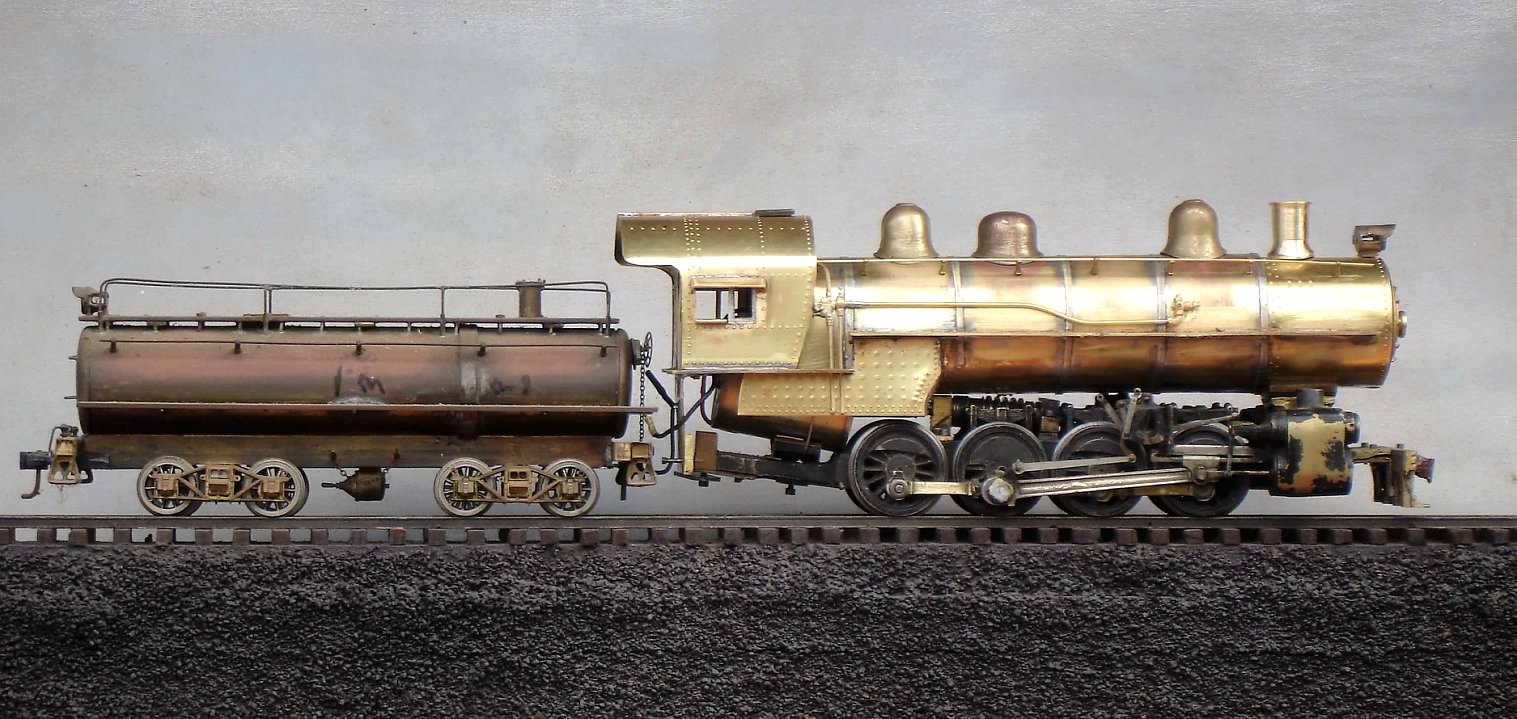

At the risk of repeating photos, here is my SP SE-4 project. It now needs lag clamps, washout plugs, boiler steps, air tanks and piping, and maybe a few other details. Air pump is mounted, sort of, on the other side. First, the ugly beginnings, then where I am today. Thanks to Bob Stevenson for the spectacular injector and check valve castings - they get painted scarlet!
