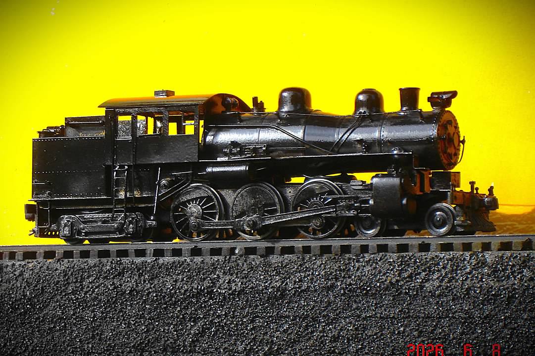

Postby bob turner » Mon Jun 08, 2026 2:11 pm
Adding the Suburban - Maroon captured the one offered on eBay last month, and offered it to me - not being a lover of tank engines, I sort of declined, but offered to complete the assembly.
These things are rarer than hens teeth - I have only heard of two of them, and one of those is in my shop as I type. Jack Jupp had the other, and at one point I had a photo. Jack and his buddies are all long gone.
Ed Bommer is delighted that we actually uncovered one, and is further delighted that we will put CNJ logo on it.
Anyway, here it is, unpainted, and needing a tad more lowering in the back. Runs exceptionally smoothly on my 68" radius test loop with a string of freight cars. It will get three CNJ passenger cars behind it when it gets back to Jim.
Uh-oh. I took it with the iPad. Shutterfly cannot handle those images. You will only see the poorly painted black version - too bad; it was elegant in brass!

Thanks for posting that. Before the horrible paint job I got it level. I may have to get the big bead blaster fixed so I can try for a repaint.
The paint looks new, but not horrible. A little light weathering would take care of any ills.

Yeah, I didn't post the horrible paint photo. Today I am stripping, blasting, removing the roof, and re-doing it:
Not sure you can tell, but I did get it dead-level. And even with all this horrible black paint it runs just fine.
