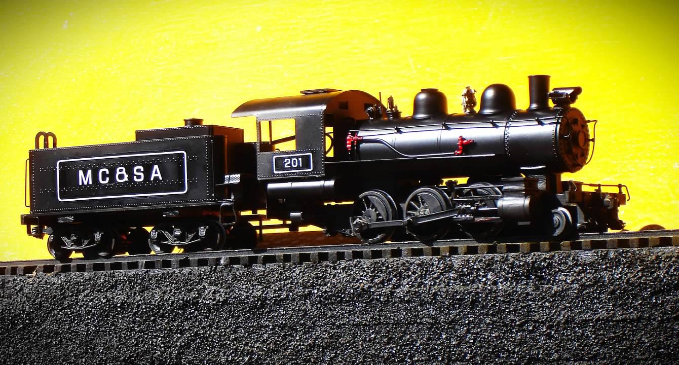

The Mongrel Mogul now has a couple coats of self-etching primer, which turns out to be smooth enough for decals! I will be happy to post more photos, but am going to hold off a bit until we get a few non-bobturner photos posted. Shutterfly has not protested the hundreds of photos I have had them host, but I still add more with trepidation. Maybe they will look kindly upon me for buying my own books?

The primer is SEM self-etching black - available on Amazon for the low low price of $28 and change for a single can. Results are as good as the old Scale Coat, and it looks smooth enough for decals. I have access to this high quality, expensive rattle-can through my honorary employment as an aircraft mechanic, but am going to lay in a can next time I accumulate a $35 order.
I suppose I freaked out a bit when my favorite rattle cans (Dupli Color) went from $4/can to $8 (now $17) but this stuff is so good it is almost worth it!

Maroon supplied gorgeous alloy tender arch bar trucks. The alloy isn't strong enough to hold the screws that hold the bolster - soweare using Lobaugh Andrews tender trucks - not bad, but not elegant.
The trucks we need are those Wabash Mogul trucks - kit K-9092 or side frames K-5167. USH did them as well - X-1040 (probably a Kemtron part #).
I will check with Wiseman - he may have the master. Meantime, if any of you have spares of those or Lobaugh arch bar tender, let us know.
The Mogul is done, except for that. Photos tomorrow, then off it goes.

Here we go - will look a bit more authentic with Kemtron trucks:
