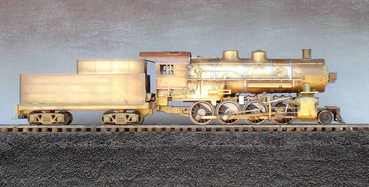

Almost finished. I am down to the half-round for the tender, some coupler pockets, a generator, an oil separator for the feedwater heater, and a couple handrails. Then, if some Erie decals find their way to my hot little hands, paint and a final photo session.
I am pleased with this one. It is not a masterpiece, but it is fairly close to quite good.

Locomotive is finished, at least for display - except for the steam pipes under the cab that go to the booster. There were two types available, and I am out of both. The ones I prefer were dummy - you had to pretend they were hooked up to the trailing truck. The other type was fully swivelable, just like the real thing. Way too fussy.
I looked at Wiseman, and will check PSC. I might have to just fake it - just bend copper wire, and try to find some flanges.
Photo is coming after the half-round on the tender and some rattle can black. I still have a half bottle of Scale Coat black that Jay gave me - this thing is good enough that I may use that.

We did have a long discussion on booster engines. Probably should have done it here -
A lot of steam locomotives had trailing truck boosters - a two cylinder steam engine that drove the rear axle at low speeds. An "idler gear" allowed free wheeling at track speeds.
The "pipes" are simulated (usually) on our models. PSC catalogued a working set - ball joints under the cab, at the lower end of a vertical pipe, and at the back of the engine itself. A nightmare to assemble in O Scale.
I found enough castings to make a pair of non-working "down pipes." I will point them out in the next photo shoot.
That was going to happen this week. All I have left is the half-round beading on the top of the tender sides. I ordered half-round (I thought) but got "round, half-hard. So, back to Amazon.

I was so entranced by that model that I had to sort of duplicate it. It is still unpainted, but now I am motivated to get out the black rattle can.
