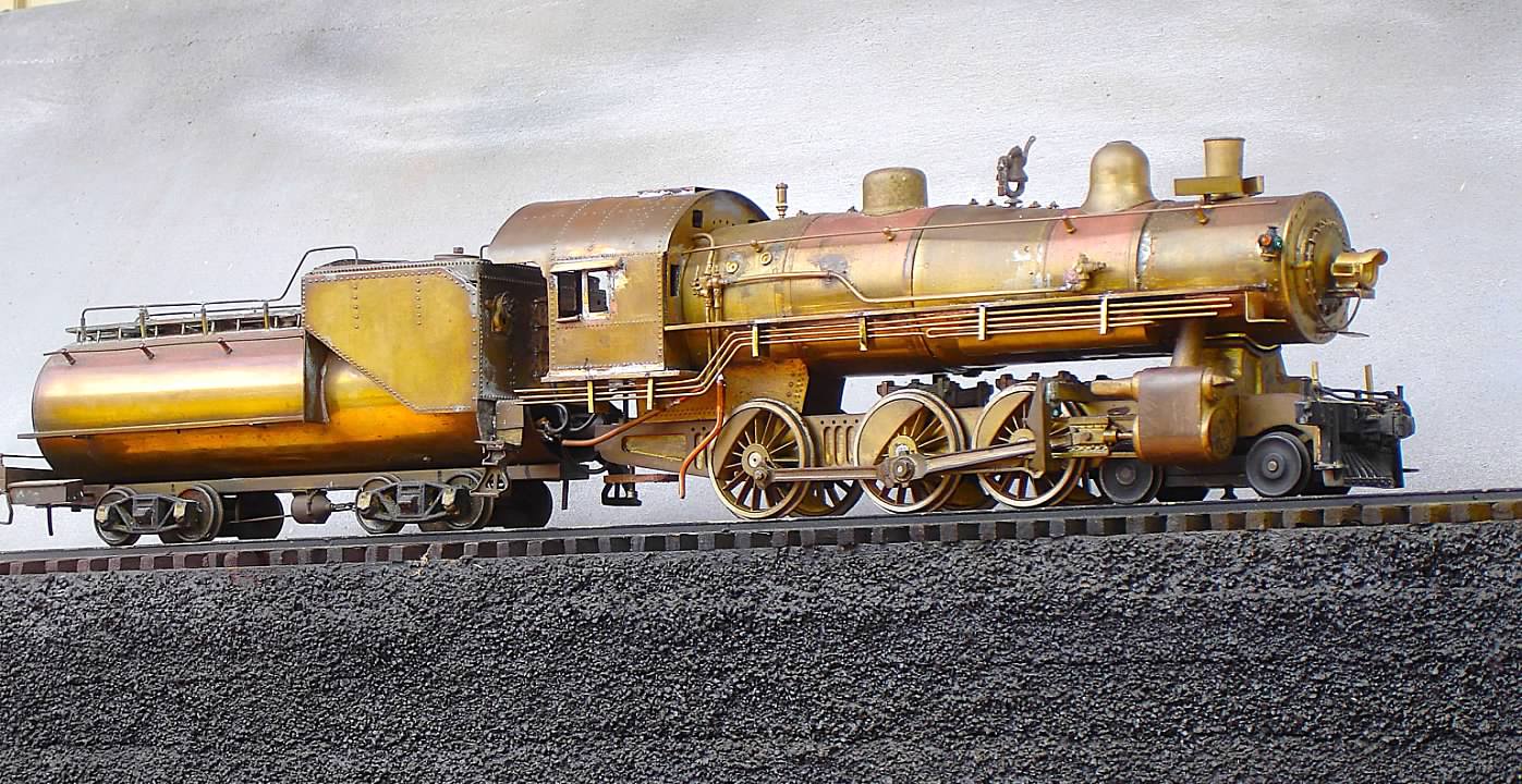

Six years ago - so time to enliven this forum with some re-run photos.
I just converted a Lobaugh Pacific frame to a Harriman Ten-Wheeler configuration, then got to wondering if indeed I need another 4-6-0. Answer - probably not. But now that I look at it, that All Nation conversion is going to get an SP cab - maybe even sooner rather than later.
In the meantime, here are some re-runs. My first Ten-Wheeler was an attempt at SP 2355, a T-32 now preserved in a park near Phoenix. It does not have a totally correct boiler taper, and the rods are simply modified rails, and worst of all the motor is in the firebox, meaning this one can haul four cars on a good day.

I should note that Bob Stevenson has provided a lifetime supply of check valves - I really should put a pair on this thing. They get painted red.
The incorrect taper is aft of the steam dome - the top should slant down toward the cab. As you will see, it is reasonably dramatic on some of these
SP locomotives.

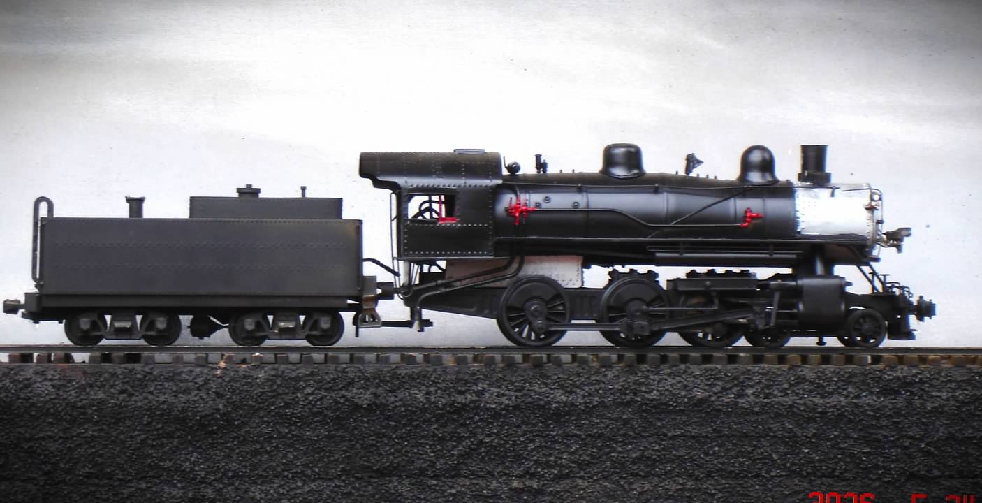

Here is one I am still struggling with. It runs well, but needs some extra stuff, like a bell and some pilot details. The drivers came from a pile Harold Peters had - he said they were Max Gray. All are the same size counterweight - all came with Max gearboxes.
On second thought, maybe I did add the pilot details:

First off both the painted and unpainted renditions look spectacular. I would not get too hung up on driver diameter; it looks proportional and accurate to my eye. Also like the spoked pilot wheels. Weathering on the painted version is also just right. If you need a bell, I can spare a couple.

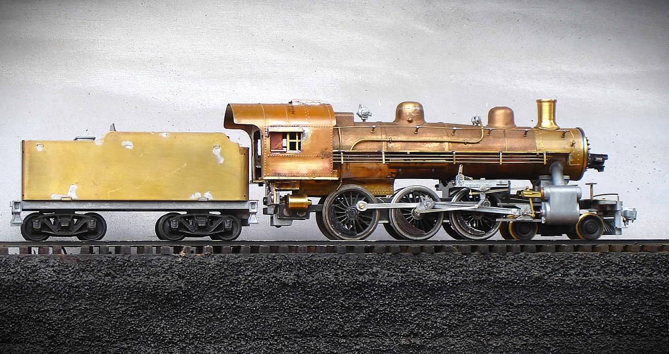

Here is the one I "lost" - the found version is a lot further along, and in addition my dirtbag All Nation has a new cab, so a photo session cannot be that far off.

Here is the "lost" Ten-Wheeler, almost finished. You can tell I got about 95%, then moved on, and only this photo reminded me to terminate the air and train lines.
Interesting story - I couldn't find the tender that goes with it, but for the photo grabbed one from an Atlantic. Turns out this is in fact its matching tender, complete with motor and U joint. I was just assembling the tender-making goodies when I discovered this one. So I still need one for the Atlantic.
