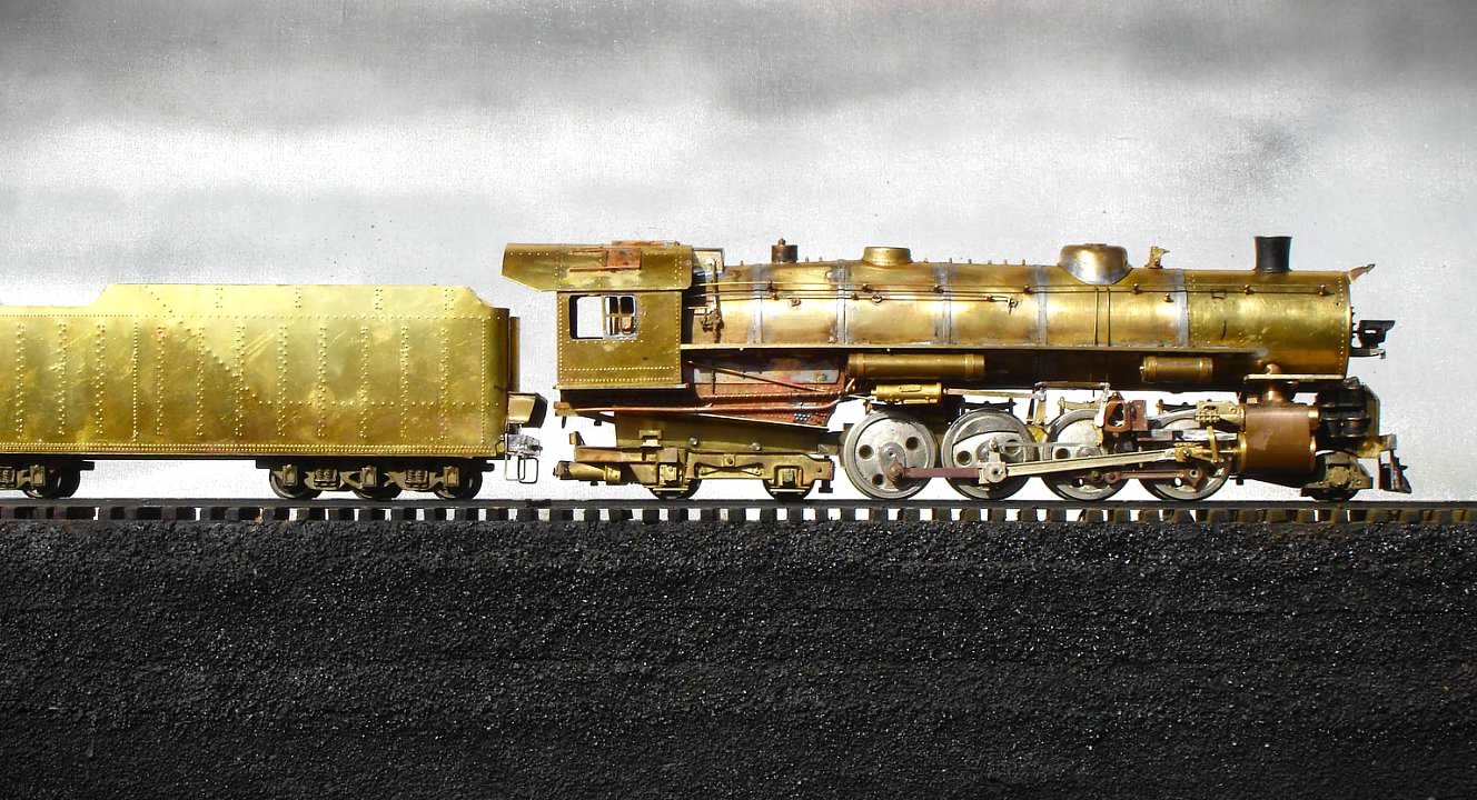

SW alerted me to a Berk on eBay - sand cast boiler and cab, All Nation tender, most parts to complete. I am not 100% sure, but I believe this to be a CLW project, and I am sure Bob etched a tender kit to match the heavy Adams boiler. Here is mine, on USH drivers. It is possible that I am repeating myself, so I will go back and check, but I don't think I have posted a photo of the CLW tender. Carey sent it last month. Good to have such great friends!
- Posts: 13430
Re: C&NW and Erie Steam Power
I would be remiss to not include a link. On closer scrutiny, the finished locomotive is most likely a Lobaugh Greenbrier. The tender shown is a well done scratchbuilt, and the iron drivers are blind on #2 and 3 axles. I doubt it has ever been assembled much further than shown. Stillo, if you want one of these doorstops, this one looks ok. In my short life I have only seen three of them.
https://www.ebay.com/itm/306832081755?m ... ecd6b06fc5

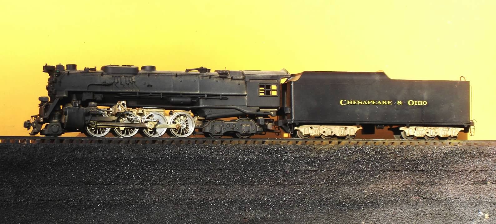

This Pacific is said to be a rebuilt Icken locomotive done by George Kanary.

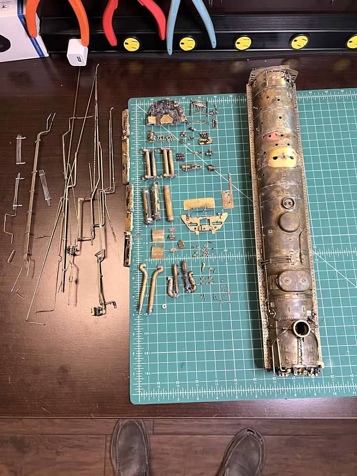

Nice models! I am currently stuck - kinda like writer's block - on the piping.
I have washouts and lag clamps installed, and debating on whether to add boiler steps, but I am trying to get to the simple stuff - a few sander lines and the starter out of the turret. Holes are drilled - I have no idea what is holding me up. I even have the lagged line for the booster ready to heat and bend, but for some reason I find myself looking for some other project - the Mongrel Mogul and ATSF Mountain were two distractions in the recent past.
So I shall get diligent - maybe the sanders and starter tonight, and the front end throttle. Maybe. I can't find my collet to cut the air tank bands, but that could be because I never had one, and simply wrapped the tube for the next larger collet.
- Posts: 13430
So here we are with lag clamps, about half the pipes, hatches on the cab roof, full valve gear, and now I am contemplating removing the cab roof one more time - it appears high in the back. A lot of work, but last time I did it I think it was under an hour.
Anyway, very close to what I want. I have been doing one simple task each day - with a lot going on in my other hobby (antique airplanes). I am in the middle of a rather extensive inspection on my Cub, and just started covering the spare Stearman wing. So doing Erie Berk stuff is like a little break.
I cannot add to Butch's post - I can only hope that we survive. This forum is pretty much my connection with the greater O Scale world, and I would miss it if it founders due to a lack of an ability to sign in.
So, current photo:
So, current photo:

Looks outstanding. I never intend and will never have the ability/talent to build a model from scratch or do heavy modification like this Bob, but I sure understand the skill and dedication it takes. Great job.

It is really hard to tell - the cab roof appeared to be "up" in the back, so I lowered the back end of the cab. You can barely see it - the lower edge of the cab now goes uphill - which means the roof itself should have been adjusted.
Done! Took exactly one hour, including re- soldering the hatches.
I might add - the stanchions holding part of the front end throttle came from my friend Boyce Yates. I thought they were HO parts, but they turned out to be 0-80 threaded.
Boyce ran the All Nation steam line for maybe a decade. I knurled his axles.
