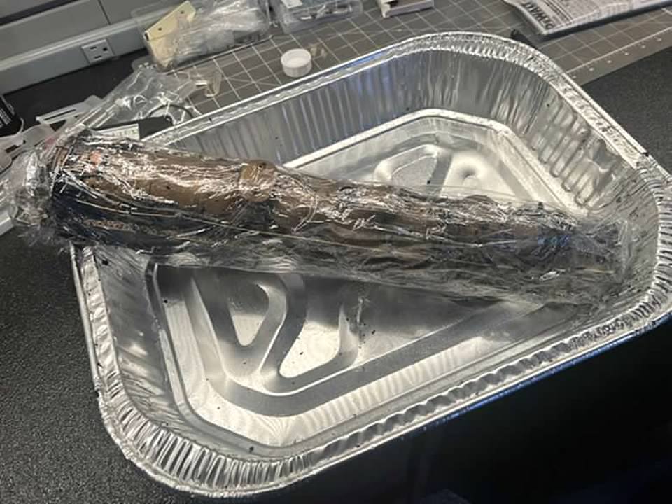

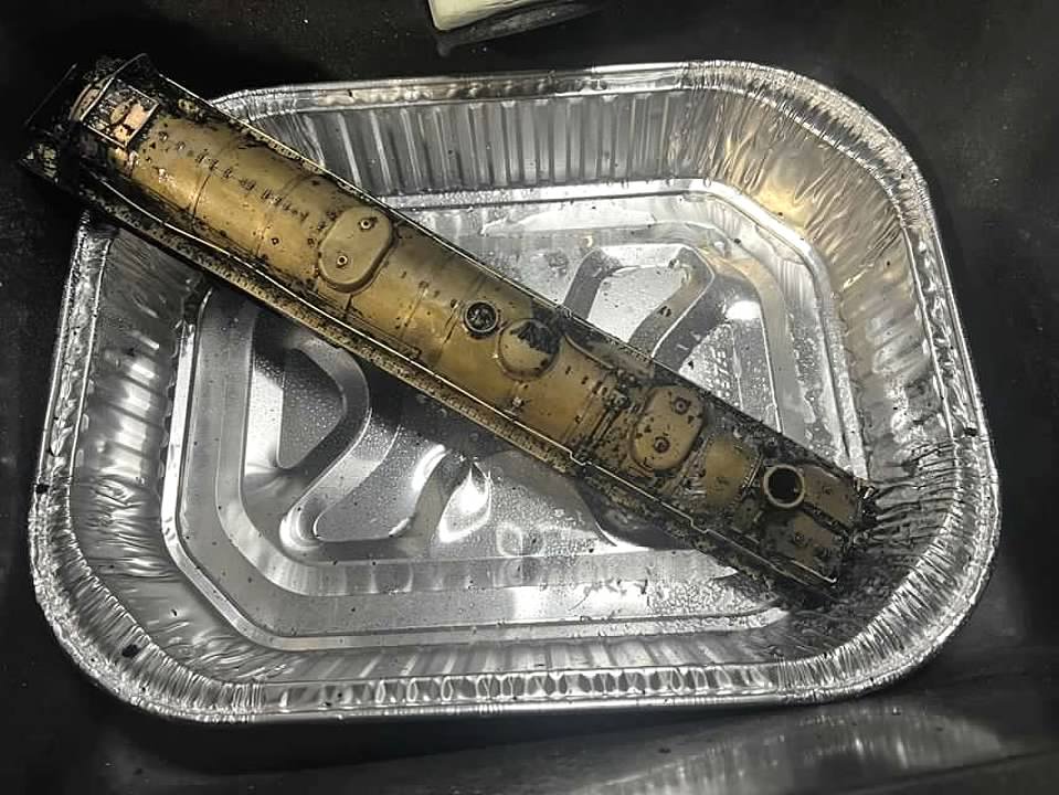

Well, I decided to strip the paint off of a 3rd Rail N5 shell I bought last summer on EB to use for spare part detail parts and I'll post the results....very impressive model and the brass sheet thickness seems to be the same as the KTM.
It's a much harder finish than the FEF was (no surprise there) and now that I've breached the paint surface in some areas and see brass, it's working faster. Since this stripper instructions say it only works when wet, I believe I will spray it and wrap it in saran wrap to keep it moist.

I recommend to people “always cover the item you’re working on” it helps keep it wet. You may find it better to use a PVC tube and cap off the ends. Shrink wrap might melt

That is a good idea Robert and I actually did that back in the 90's with brake fluid...........works fantastic....hated the clean up. I may do it on this model using this stripper as well, but I can't get out right now to buy the PVC pipe and caps.
So, I decided to try wrapping it in saran wrap and see how it does. This remover comes in gallons too and I thought I could completely submerge it in this solution using the PVC tube idea. We'll see how wrapping does.
The unwrapped photo is after several sprays and light brushing with an acid brush.

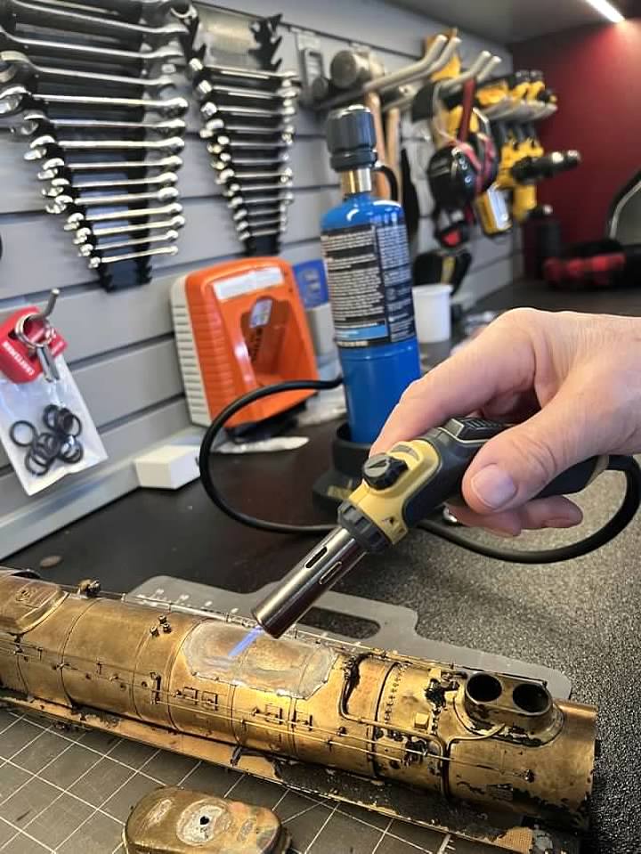

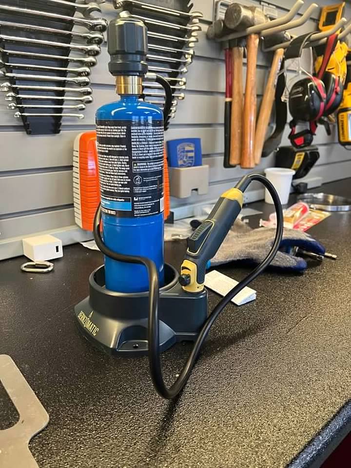

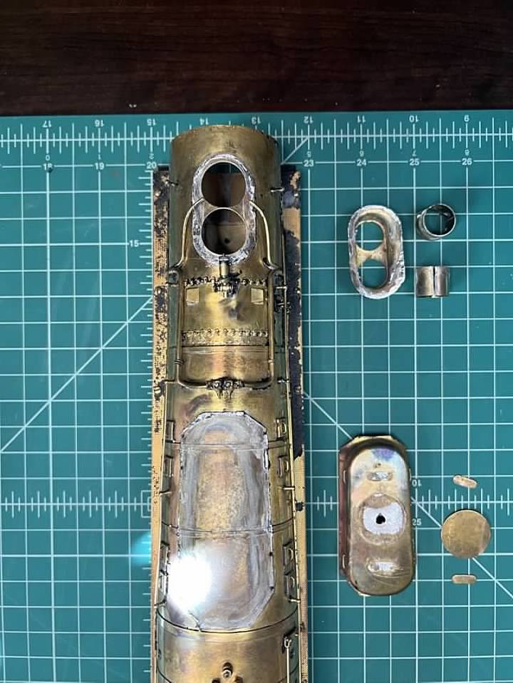

I bought this BernzOmatic hobby propane torch off of Amazon ($40) and it arrived last night. I just used it......and once I realized I should melt the dome solder from inside the boiler and not from outside, the dome literally fell off in 4-5 seconds. The fake hatches came off in seconds as well.
The stand holds the bottle tight and the holder for the torch is metal lined to handle it when it's hot. The flame can be adjusted a little further down than shown in the photo....and much larger if needed.
I have a lot to learn to use this torch correctly and great caution will be the order of the day, but so far I love it. Obviously the right tool for this type of job and the price was reasonable IMHO.

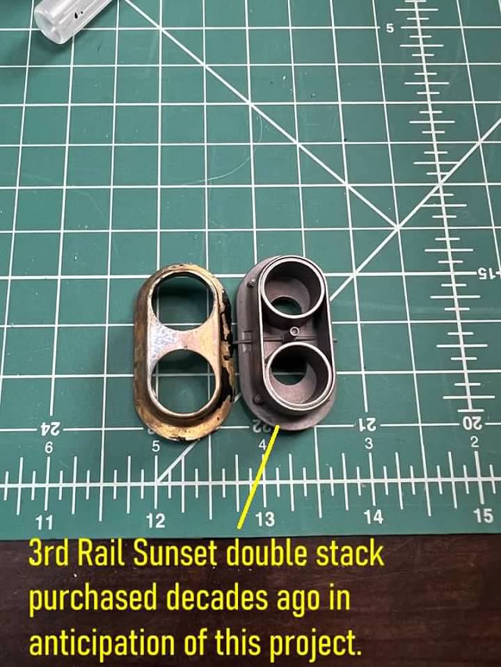

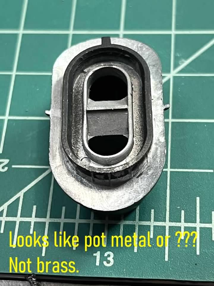

Removed the stack and very interesting how it was fabricated by KTM. The new stack was bought in the late 90's or early 2000's from 3rd Rail parts department in anticipation of this project. I'm very glad I did as it is right up there with KEY or OMI except it's not brass......looks like some type of pot metal. But, once I grind off the metal under the skirting that fits into the original 3rd Rail FEF it will fit perfectly......or maybe just open up the top of the boiler and forget the grinding.....don't know at this stage.

The 3rd Rail casting alone will really improve the model. There’s something about putting on a nicely detailed stack, it just changes the whole look of the model.

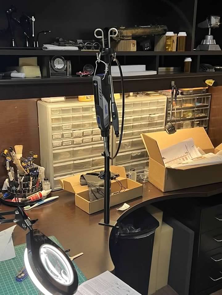

Well, I haven't done much modeling on this project, as I've been acquiring tools, parts and ideas to make the task easier and more successful. So, this is more like a show and tell, than any model progress.
I took Roberts advice and bought (sticker shock) the parts to make a 4" x 24" soaking chamber. I built one decades ago and used brake fluid for stripping, but soaking in the Maxi Strip will be a much cleaner operation.
It was also suggested to me, that I could use a Dremel and flex shaft tool, with an end mill bit to open up the sand and turret domes or anything else on this model. That never occurred to me.....it should have.....but it didn't. I've been fretting about getting a mini drill press or mini mill, but the cost is exorbitant and I wasn't willing to spend the $$. The sad part is the same machines I saw 20-25 years ago are now selling for 3-4 times more $$$.
I got the old Dremel out and the flex shaft tool I bought in the 80's and neither was up to the task tackling this project. So, both are going to my 14 year old grandson who just got into building plastic model boats and tanks.
So, I took the plunge and bought a new Dremel 8250 cordless model and the newer/upgraded 225-02 flex shaft tool, plus a hanging stand. Best money I've spend in a long time and way more reasonable than I imagined. The torque difference between the old 7800 and the new 8250 is night and day. I could stop the 7800 "easily" at almost any speed, while the 8250 will almost peel the hide from your finger trying to stop it at 5000 rpm.....you can stop it, but the effort needed is a magnitude higher than expected. And, I will need that torque if I'm going to hand mill openings in this model.
