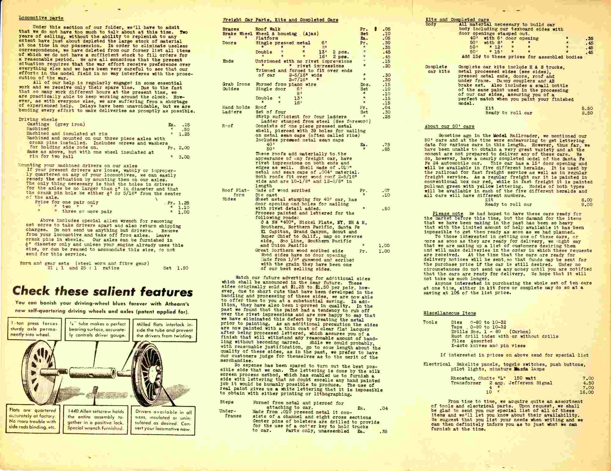

Yes, they made them.
Biggest difference between theirs, all the others, and how to identify? Similar to the half axles they use on their HO stuff now. Their drivers had axles the were slightly over half the length of a standard O Scale axle but the extra portion was machined with a flat (like we see on most diesel drives). They were machined so that when mated up with the other half (a sleeve slipped over the two half axles) they were automatically in quarter. The worked just fine but weren't really accepted and went away. I had a set I gave away...to Bob I think. Got them from Si.

Since you asked: Athearn catalog attached ---- I hope!
Charlie
Charlie
